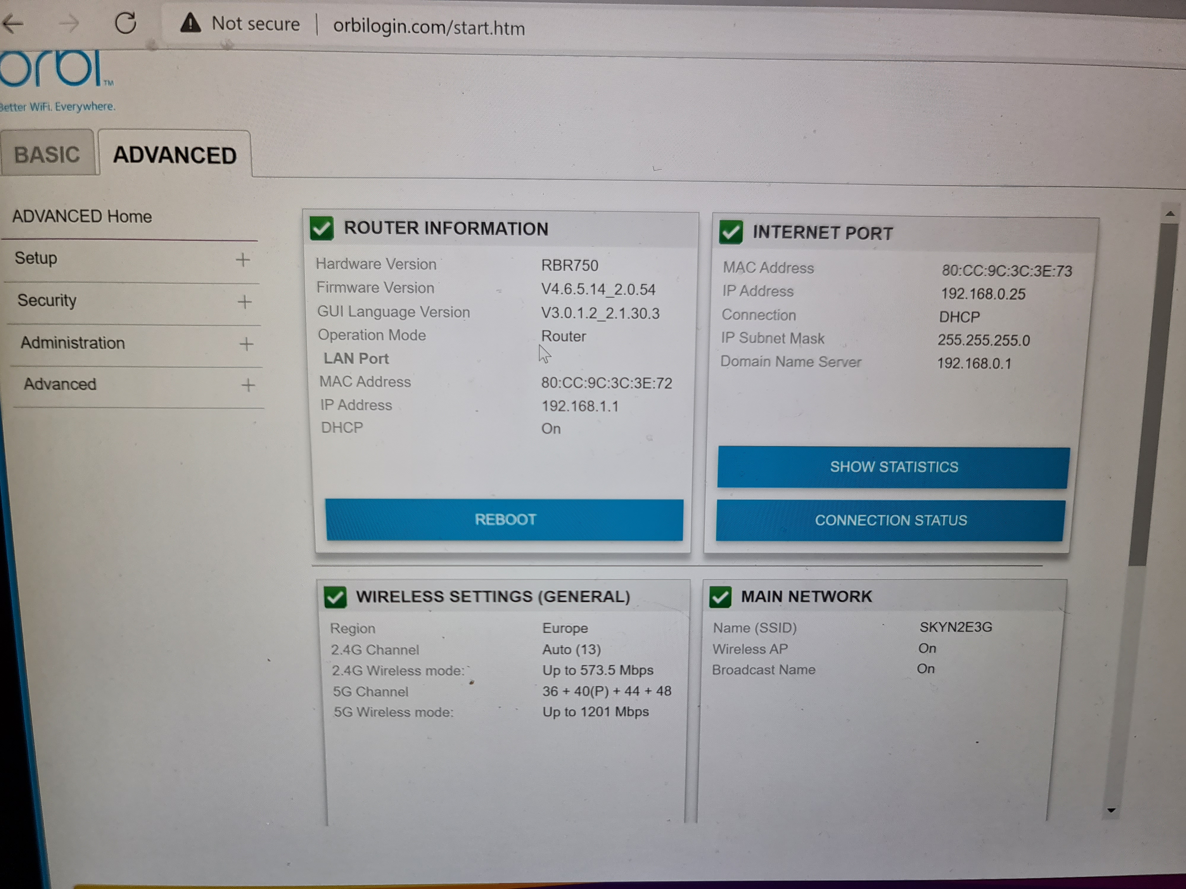

- carlb1981Dec 28, 2021AspirantFURRYe38 I've finally getting around to trying to solve my slower speeds issue, today I've tried turning my orbi router into AP mode but it caused problems with Internet connection. The connection to router itself kept dropping out and purple light kept showing and could get my devices to connect over WiFi either. So I put it back into router mode for now. I'd like to give option 2 a go as that sounded the best option anyway as I'd still be able to use app on phone to manage the orbi system. I'm just unsure what info I need and where to get it. I checked my isp router settings to see if I could find what needed changed and found this(photo attached) if this is what's needed to be changed where do I get the info needed from the orbi?

Carl- FURRYe38Dec 28, 2021Guru - Experienced User
Sounds like a configuration issue on the RBR when in AP mode.
Take the IP address that the RBR in router mode, gets from the modem, seen on the RBR advanced tab under Internet section. The WAN IP address seen there, set up a IP address reservation on the modem for this IP address so it doesn't change. Then put this IP address into the modems DMZ or IP Pass thru. Contact your ISP if you need help on how to do this with your modem/router if you need additoinal help and information.
- carlb1981Dec 28, 2021AspirantIs it the ip address in right hand box in photo attached that I need 192.168.0.25?
