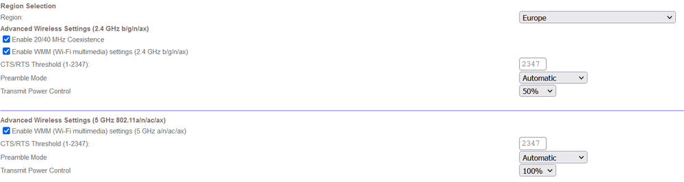

1) Could you please advise whether the advanced wireless settings copied below are optimal? Note that AX is enabled as well.
2) What does the CTS / Threshold mean and what is the optimal value?
3) I recall having set the 2.4 GHz power to 50% to avoid mixing router (on 1st floor) and satellite (on 2nd floor) signals, but now I see the phone switching to mobile data few meters from the satellite (incl. walls).Thank you
