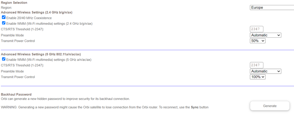

Configuration: RBR750 and RBS750 via ethernet backhaul; AP mode Firmware: V4.6.14.3 Since few weeks, some applications on my Android 13 phone intermittently don't work while on the Orbi WIFI, bu...

I would try default 64 first for CTS. See if the phone exhibits any better results, then try 500.
I would reduce the power on the 5Ghz as well to same value as 2.4Ghz.
Uncheck the 20/40Mhz co-existence box.

1) Reduced WIFI output power to 50% on both frequencies (5G was 100% and 2.4G 50%).
2) I am using channels 06 and 48. Proceeded with a channel scan using an app and these channels seem to be OK; so no change here.
3) On 2.4 GHz: Unchecked 20/40 MHz coexistence and disabled AX.
