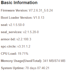

Just curious, whats the system uptime show on your 850 series?
DarkNet wrote:
I have a 4200sqft house and have been using a RBK853 system (router plus 2 satellites) for the last couple of years without any connectivity or signal strength issues. YMMV but its been ok for me. I have the router upstairs on 2nd floor and the two satellites on the first floor. They control 7 TVs (rarely more than 2 TVs on at a time) and many home automation devices. We have 1Gbps service from Xfinity. I have several IoT devices on a separate SSID.

Is there a time value seen for the RBR and RBS?
- DarkNetDec 18, 2024Apprentice
I dont know where to look for that.
- FURRYe38Dec 18, 2024Guru - Experienced User
Two places, RBRs web page under Advanced Tab/Internet section/Show stats and router IP address/debug.htm
- DarkNetDec 19, 2024Apprentice
I powered down the system a month or so ago for some re-cabling.
