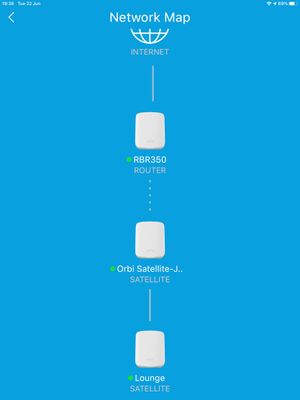

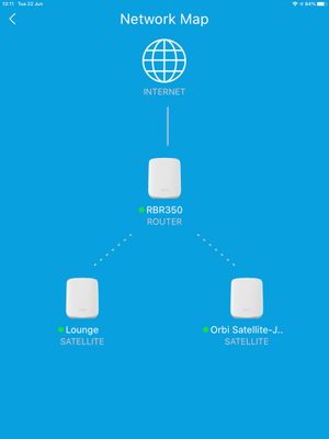

Picture of network map with connections as before.
I then added a cat5 cable from the RBR350 to the switch that is connected via Ethernet to the switch that satellite Lounge is connected to. Picture below, solid line is correct but it is not connected in any way to satellite J. Router page shows it is connected by wire and back haul good. 2 out of 3 better than before!
