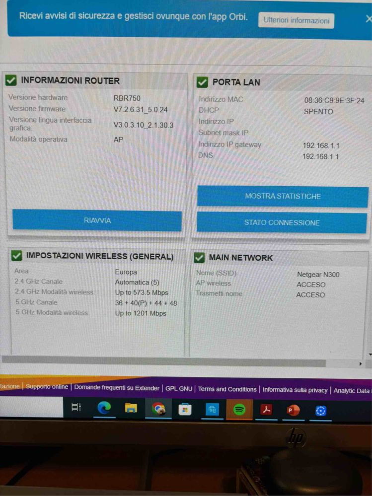

Does this happen with both wireless and wired devices? I have only wireless devices connected to RBS
What channel configurations are currently set on the router? Please see the picture belowHas a factory reset and setup from scratch been performed since last FW update? Yes, it worked well for a will but now the problem occured again.
