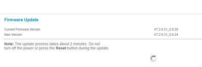

unable to flash router in 960 mesh system
Anyone having this issue with not being able to flash the main router? I was able to flash the satellite's as instructed first, and now no option to update main router. Any advice?
- Apr 09, 2024
On the Manual Update page, the router update is "above the line". Browse to the location of the router firmware file and then upload it.
Satellites appear "below the line".
Apr 08, 2024Guru - Experienced User
Download the v.31 RBR FW file to your PC, then use the manual tab and after the .zip file is unpacked, send the .chk file to the RBRs web page.
t0ny103
Apr 09, 2024Aspirant
I tried that and only the 2 satellites appear on the manual update. The main router does not show up on the manual update list as shown on the screenshot I posted.
It’s strange.
It’s strange.
- CrimpOnApr 09, 2024Guru - Experienced User
- t0ny103Apr 09, 2024Aspirant
It worked!! It gave me an error wen I tried this upload option yesterday.
- FURRYe38Apr 09, 2024Guru - Experienced User
After the RBR is updated and all is back to ready, I recommend a power OFF of the RBR and RBS for 1 minute, then back ON with the RBR first, give 30 seconds then turn on the 1st RBS, give another 30 seconds then back on with the 2nd RBS. After 5-10 minutes, system should be settled in and working well for you.
If all is good, make a new backup configuration to file for safe keeping:
https://kb.netgear.com/000062080/How-do-I-back-up-the-configuration-settings-on-my-Orbi-WiFi-System
Ya, seems odd, like the RBR serial number wasn't included in the AU system but the RBS serials were.
You'll be ok to manually update the RBR by downloading the RBR file and applying it using the manual tab there.
