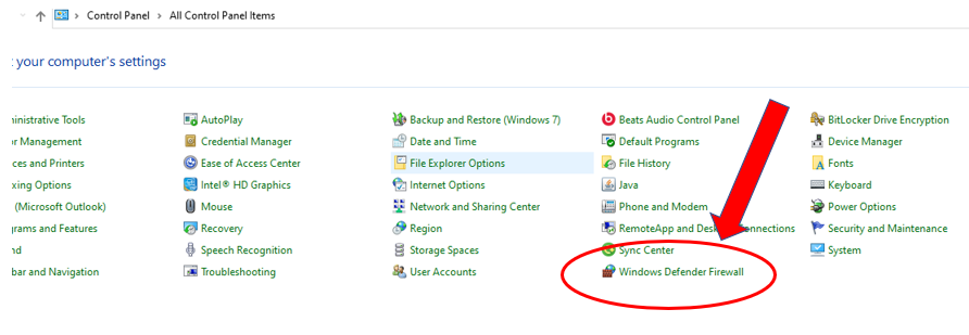

My experience is that every version of Windows includes the Windows Firewall.

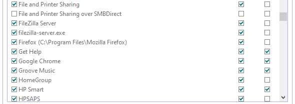

99.9% of software that user's install do not require permission to allow access into the computer. Since installing software requires administrative rights, either the installer just adds programs to the Firewall exceptions or pops up a message asking if the user agrees. Windows Firewall has separate rules for private IP networks and public IP networks, and it is really common for the Firewall to allow some programs to accept connections from the LAN, but not the internet. Here's a sample from one of my desktops:
It appears that Windows is not exactly precise about removing Firewall rules when software is uninstalled. (If it's gone, who cares?)

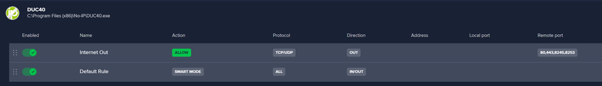

In both computers the windows firewall is controlled by the antivirus software. The computer uses Avast (paid subscription) and this is the configuration for DUC. Notice that the allowed ports are the ones mentioned by the No-ip support guy. So as far as i can see the DUC is allowed both ways.

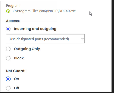

The laptop uses Mcafee for the antivirus (Paid subscription) and this is the configuration. So as far as i can see the DUC is also allowed both ways.
The DUC installation does not have a popup to configure windows firewall exceptions. The installations are done under administrative privileges.
