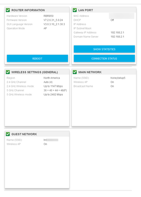

Use my Netgear device as a router with a Bell modem
I have an Orbi RBR850 router and 2 satellites. My Orbi routes is connected in AP mode to the Bell modem SagemCom Gigabub fiber (one of the modem switch ports goes to the Netgear internet port) My n...

And I have looked in the RBR, I do not have an Internet section under advanced...

Do the following on the modem, disable ALL wifi radios on the modem, configure the modems DMZ/ExposedHost or IP Pass-Through for the IP address the Orbi router gets from the modem. Then you can use the Orbi router in Router mode fully. LAN port is same area and section for Internet section seen on the RBRs web page. So that 192.168.2.x address is what the RBR is getting from the modem. Put that into the modems DMZ.
