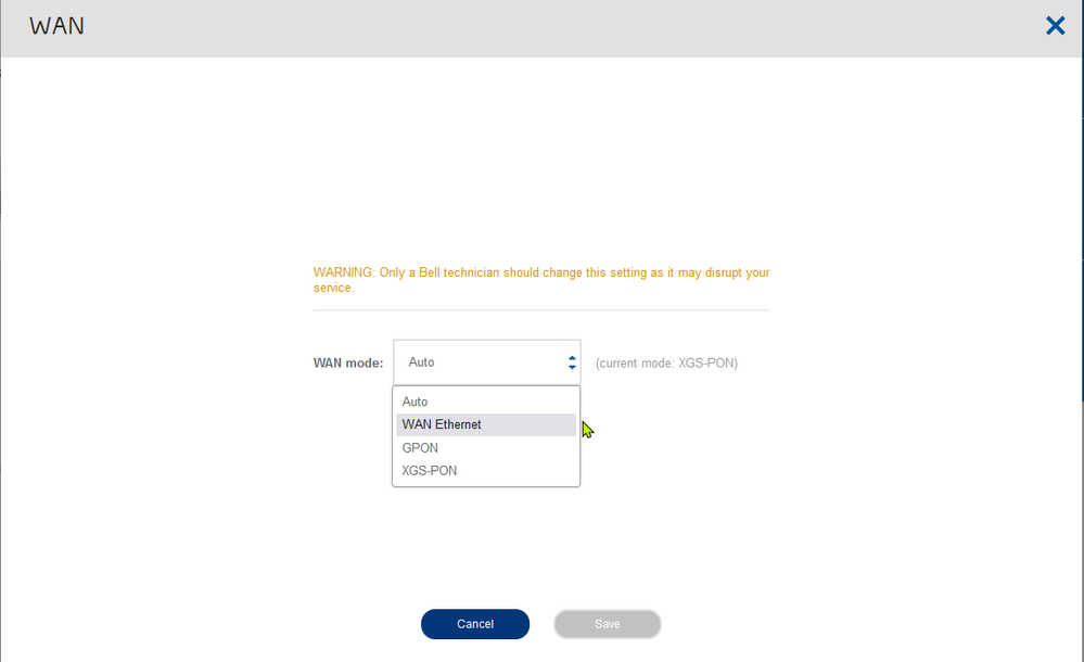

I might have found the way to use the modem in bridge mode.
Do you know anything about this?
