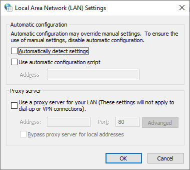

I have time set aside on Saturday to reset and rebuild the router, but had a question in the interim. Someone else I spoke to in the real world indicated this could be a proxy server setting issue with the Orbi. The error I'm getting on my work laptop sometimes is that windows could not automatically detect the networks proxsy settings. I hit refresh on the site then and it almost always seems to work. This is a windows 10 machine using either internet explorer or chrome (same error whether ethernet connection or wireless).
- FURRYe38Apr 23, 2020Guru - Experienced User
Try looking at Control Panel/Internet Options/Connections tab/Lan Setting button"
The Automatically dectect settings can be either checked or unchecked. I have kept this uncheck since the days of XP. I was told a long time ago that this setting can cause varied problems.
