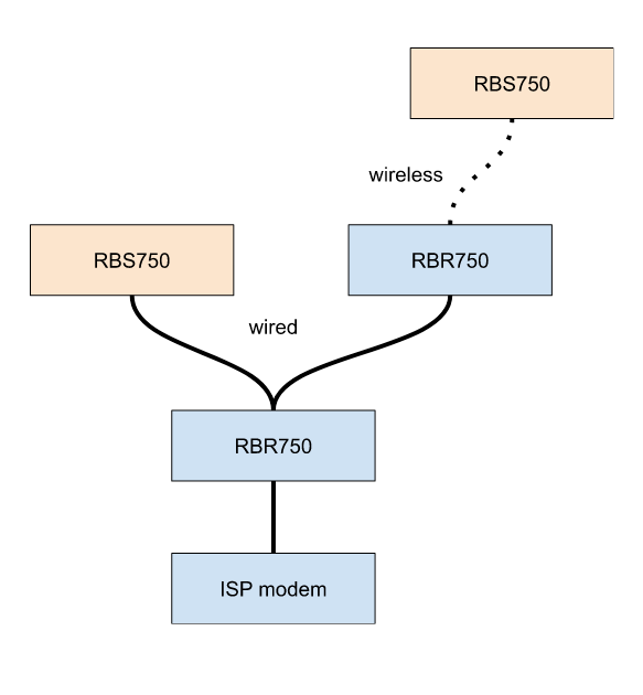

Saying that, given how challenging I've found using the Orbi RBR750 + 2x RBS750, I'm hesitant to add a non-mesh-wifi extender to a mesh system. Perhaps I should just try another RBS750 with wireless backhaul to the wired one in the neighbouring room?
And now I've just found a refurbished RBR750 locally at a bargain price. So could I have our current RBR750 connected with wired backhaul to one of our RBS750, and with wired backhaul to this refurbed RBR750, which will then connect wirelessly to our second RBS750?
Here's a quick schematic just in case my description leaves something to be desired.
I won't buy it until someone more expert than me here says go for it!
