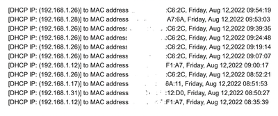

Weird log entries and iPad showing as "wired"
I got a log dump today and noticed that one device had abouyt 6 DHCP requests in an hour. It's the one below ending in C6:2C:
Now that device happens to be an Apple iPad. Further, that iPad was not being powered off/on, going thru restarts, updates, etc. In fact, it was probably not being used at all (it's my wife's) - it was sitting on a table with an excellent wifi signal.
Note also on the advanced/security/access control list of the router's web oage, that iPad shows as "Wired" - it most certainly is not nor has it ever been.
I know the second is probably a bug of some sort, is the first issue (all those DHCP requests in an hour) normal? Also, is it normal to get a log dump of so few entries? I just got one this morning, the first in 9 days, it only had 11 entries. This also has 11 entries. Is it not showing all the entries in the log?

    Oh yeah, something is really broken.....the Log has 23 pages worth of DHCP requests! And that iPad has had 571 requests since 7 AM this morning, 8 hours ago! What could be wrong?

      Could you please identify the specific model of Orbi router?  There is a known problem with the log function on specific models.

        Sorry I should have, it's a RBR850.
