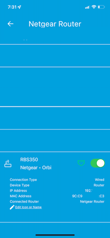

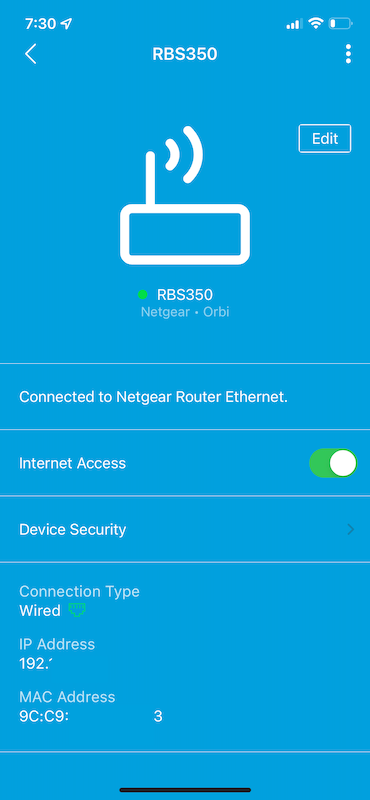

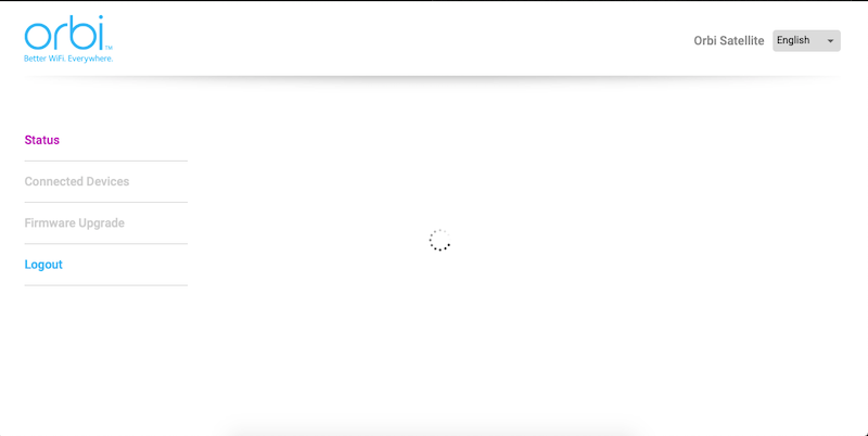

I have taken the RBS thats just flashing and plugged it directly into the RBR.
I then took the IP address and popped it online and i just get a spinning ball as per the third picture.- FURRYe38Jan 06, 2022Guru - Experienced User
So selecting the Firmware Upgrade seen on that page doesn't do anything?
Lets see if you can do this:
Have the RBS FW file at the ready on your wired PC.
What you need to do is factory reset the RBS. Wire connect a PC to the 1st satellite📡. Already have the most current FW version files downloaded on to this PC.
Wire connect 1 PC to the back of the RBS. Factory reset the RBS, wait about 5 minutes. The PC will get a IP address from the satellite📡. The RBS will be 192.168.1.250. Use this IP address in a web browser to log in to the satellites web page. Log in as admin and password. Use the satellites 📡 web page FW update feature to select the FW update file that was unpacked from the .zip file.
