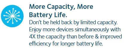

    Could you please post a link to this Netgear statement about "40 devices".  I could not find such a statement on the official Product Data Sheet.  What I did find is this statement:
    My ancient RBR50 is putting along just fine with over 40 devices (most of them are idle or are IoT 'gizmos'). If my old router can support over 40, surely "4X" means "more than 50+".
    Compare the processors:
    RBR50 - Qualcom IPQ4019, 4 ARM Cortex A7, Clock Speed 171MH, 2 spatial streams
    RBR750 - Qualcom IPQ8174, 4 ARM Cortex A53, Clock Speed: 1400MH
    It will be nearly impossible to connect more than one Class C subnet (255.255.255.0) of devices, which  amounts to about 253, including the router, satellites, and user devices.  In practical terms, the "sky's the limit" on the 750 product line.  The WiFi radio spectrum will saturage before the router does.

        CrimpOn - The 40 device limit is on the main netgear home page, in the brief description of each current Orbi system. It's also on the specific product page, in the main product summary text: https://www.netgear.com/home/wifi/mesh/rbk753/
        Absolutely correct, "for over 40 devices", plain as day.  More impressive than "over 20 devices", which one would think is also correct.
        Marketing literature is always amazing (to me).
        A couple of years ago, there was a post on the forum from someone who claimed to have over 120 devices on the original Orbi.  Surely the number of "devices" a WiFi system can accomodate must have some relationship to the usage these devices impose on the system and on the WiFi channel capacity.  100 smart plugs that together do not send 1mb of data a week is a lot different than 20 laptops playing World of Stupidity (or whatever).
        My money is still on the Orbi firmware issues, not the hardware.
