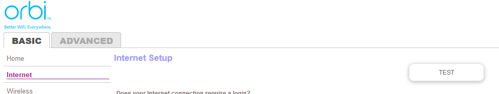

    Notice on the web admin Basic tab, the option to "Test" the internet connection:
    How about using the pfSense to capture traffic from the Orbi WAN port.  This would reveal what the Test function is doing (in router mode), and might also reveal what address the Orbi is attempting to Ping in Access Point mode.

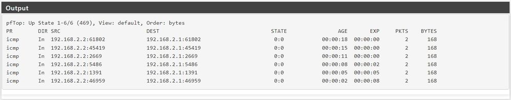

      Well, I haven't generated a .pcap capture but even with pfTop on the firewall you can see the Orbi (in AP Mode) 192.168.2.2 CONSTANTLY pinging the firewall 192.168.1.1, seems to be at a rate of between every 1 or 2 seconds.
      Topology is cable modem LAN port plugged into pfSense WAN port, then pfSense LAN port plugged into unmanaged network switch, then network switch plugged directly into Orbi WAN port.  The switch has many other items plugged into it as well, however none of these items are pinging the pfSense.  As soon as I tell pfSense not to respond to the pings, immediate and repeated restarts of the Orbi.

        This looks pretty clear (to me).  Orbi engineers wanted some mechanism to validate that "something is out there" and decided to Ping the device that assigned its IP address with DHCP. The standard DHCP process does not typically include further connections until half of the lease time has expired.  With typical lease times being 86,400 seconds (one day), that would be a long time.  This conjecture could be validated by changing the DHCP server (temporarily) to a different IP and watching to see if the Orbi begins to Ping that host instead of the pfSense itself.
        My guess is that the issue is resolved:
        no ICMP response means "No Network".
        Very creative experiment.
