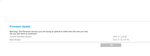

Why wont netgear allow me to downgrade my firmware, where is the "yes" button? (RBR750/RBS750)
First off, why isnt there a "disable automatic firmware update" option? This is a bit ridiculous. Ive spent close to 800-850 on my entire setup including an additional satellite and support contracts...

Users can try this:
Seems to work to get back to v3 FW.

Godfirst wrote:
Will not work since I’m on 4.6.3.9 and rbk852.- GodfirstAug 25, 2021TutorI was able to finally revert firmware, by using the debug screen suggested in the discussion. Thanks! Everything is back to normal.
