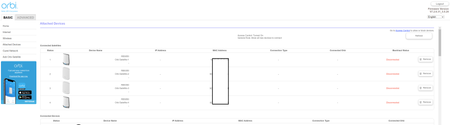

Hi all, I do have a problem with my RBR850. Since a few days it is constantly dropping WiFi: on the router everything is OK - no issues but no device can connect getting stuck at "getting IP addr...

I do have a problem with my RBR850. Since a few days it is constantly dropping WiFi: on the router everything is OK - no issues but no device can connect getting stuck at "getting IP address". Only reboot helps for a few hours.
RBR850 has 4 satellites.
All firmware is up to date (1x RBR850: V7.2.6.31_5.0.24, 2x RBS850: V7.2.6.31, 2x RBS350: V4.6.14.3)
