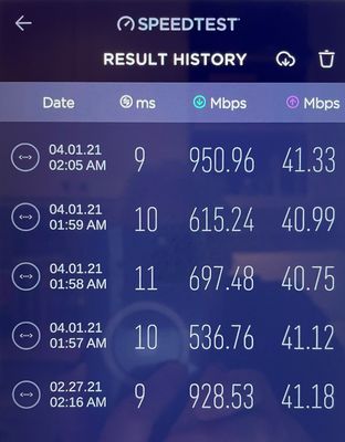

I did a quick test like I said I would. The computer I ran speedtest on is usually directly wired to a switch that goes to the orbi and then to the WAN. The first result of 928 Mbps is that setup from a month ago. The 2nd, 3rd, and 4th results in the 600s are with that computer wired into the BRS850 satellite port with the satellite using wireless backhaul. The final result of 950 Mbps is with the satellite using wired backhaul, which is clearly better for my installation.
- FURRYe38Apr 01, 2021Guru - Experienced User
Thanks for posting your results. Good to see that is working well for you.
