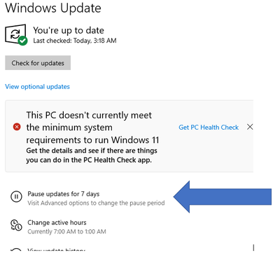

My Windows 10 offers an option to "Pause" updates:
Does Windows 11 not offer that option? One tactic might be to disconnect from the internet, do the Restore, Set the option to postpone updates, then reconnect to the internet.
