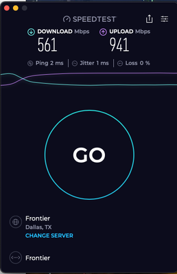

      The below is a speed test example on wired.  note that the upload speed is what I expect for a 1gb connection and has never been an issue - only download speeds.   Note the drop in the blue line indicating that a download test starts at a higher speed and then decreases to ~ 500mb.

      Speed test results same across two wired PCs? - Yes the issue is the same for two different MacBooks from two different wired drops in the home.  Have tested these drops to 1gb with iperf3 consistently so believe I am getting consistent wired speeds and do not have a cabling issue.
      Also as I mentioned in the original post, direct connection to the ONT produces consistent speed results (topped out at 1gb).  it is only when I use the RBR850 and its LAN ports that I am experiencing the issue with degraded download speeds.
