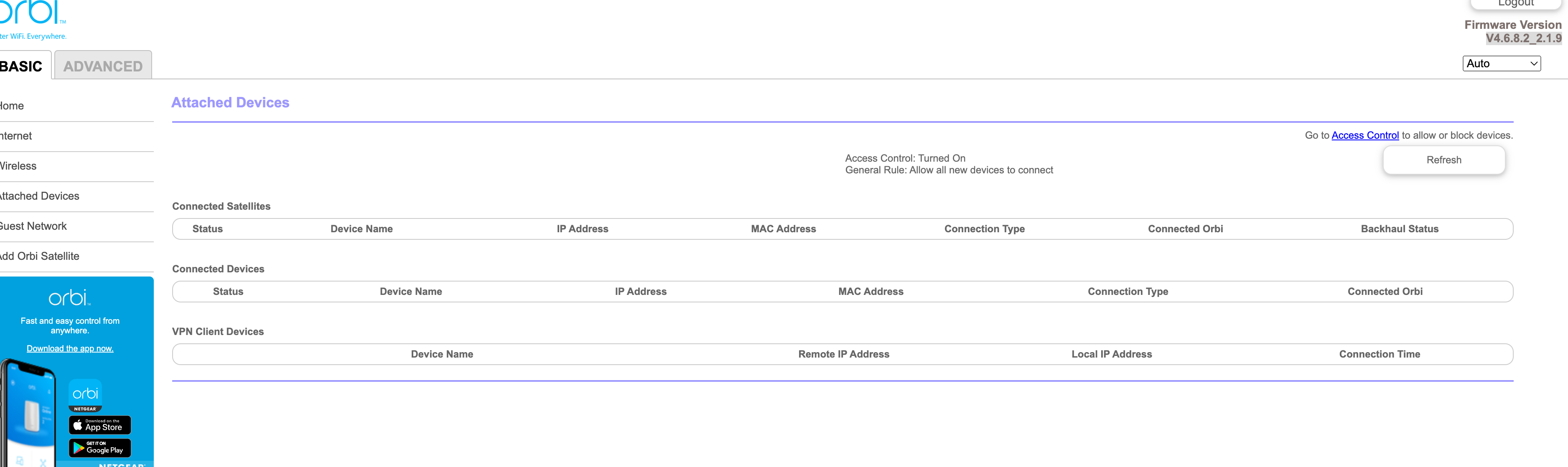

Any updates from Netgear on this??? I'm continuing to have this same issue. I have 100+ devices and 9 satellites, nothing is showing up on the web interface at all. I'm running V4.6.8.2_2.1.9.

I'm not exactly certain when they stopped showing up but it's been at least a month. I can see everything on the app, just not on the web UI. I also verified the time is correct on the NTP settings.
Here is a screenshot of the page. I have the following switches in the mix. All are Netgear. Rack-mounted POE, rack-mounted non-POE, and two 8-port gig switches. I've never had an issue before and nothing has changed from a hardware standpoint. I'm running Chrome

Please post a screen capture of what your seeing on the Connected Devices page.
Edit out all MAC addresses seen on this before posting.
