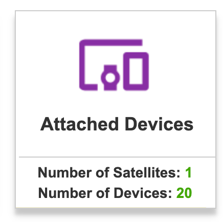

Oct 10, 2023Mentor - Experienced User
Just checked again, router admin page says this, which is probably why devices on upper floors won't connect to WiFi. Also, as a note when I power cycled the router and 1 RBS individually this morning, both came up fine (no color for RBR, RBS was blue).
