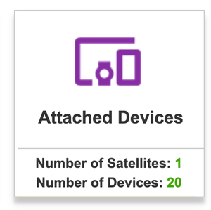

Just checked again, router admin page says this, which is probably why devices on upper floors won't connect to WiFi. Also, as a note when I power cycled the router and 1 RBS individually this morning, both came up fine (no color for RBR, RBS was blue).

What is the brand and model# of the switch in between the RBR and RBS?
What happens if you disconnect the switch and let the RBS wirelessly connect to the RBR?
- donawaltOct 10, 2023Mentor - Experienced User
went out for a meeting, came back, WiFi is down for everybody - laptops, devices, etc. Wow this is nasty. Haven't touched the network other than power cycles this morning - did one right before I left of everything in the proper sequence with waiting in between. The switch and router/modem appear fine, I can use the internet through 4th-connected laptops. The switch is a NETGEAR 48-Port Gigabit Ethernet Unmanaged Switch (GS348).
