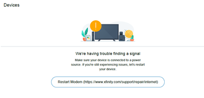

Xfinity cannot find signal from CBR750
Hi,
I always got this status below for my CBR750. Looks like it is the cause of lots of internet drops. Xfinity said the activation process cannot complete due to this. Other modems work fine with the same cable. Netgear support just keep making excuses and cannot fix it for weeks. Any suggestions will be appreciated!
