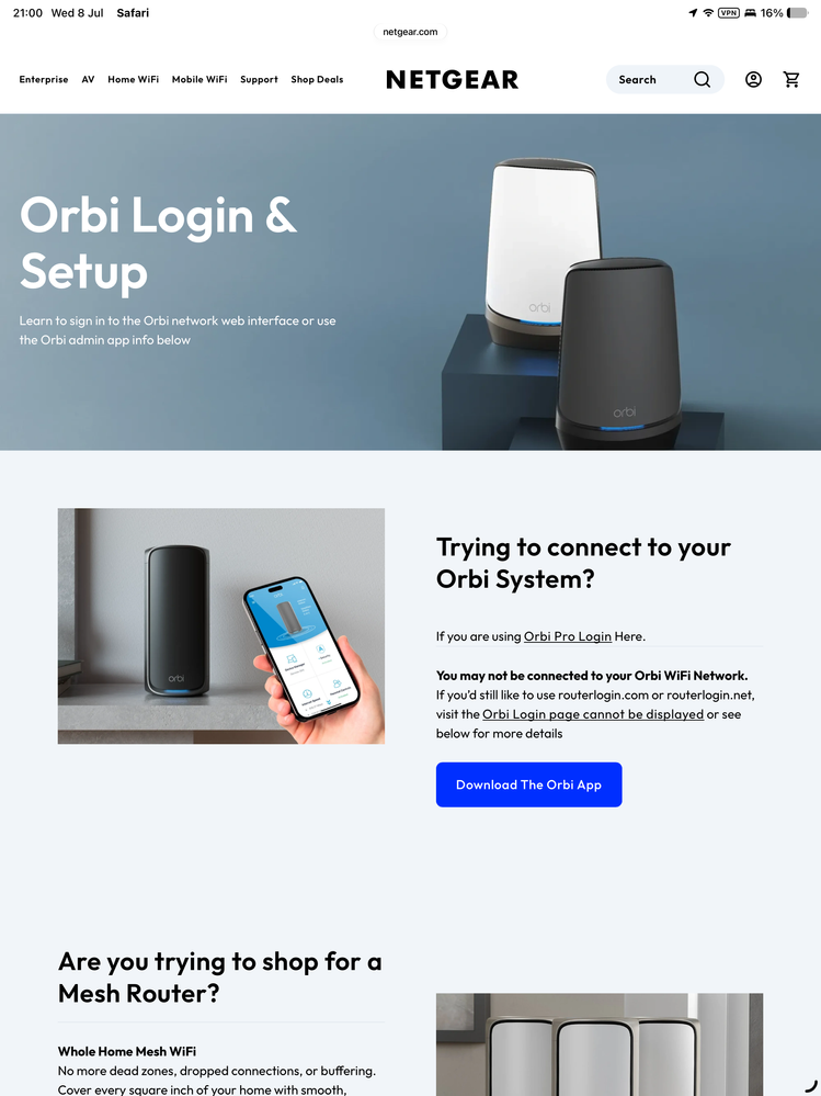

The suggestion to use orbilogin.net is on the base of the 871 router. However that, along with all the other’s mentioned in your reply fail from here at least and simply resolve to a generic Netgear support page suggesting I instead use the app (see attached)
This support page, although not 870 specific, seems to suggest using orbilogin.local or 10.168.168.1 both of which are accessible from my internal network here.
