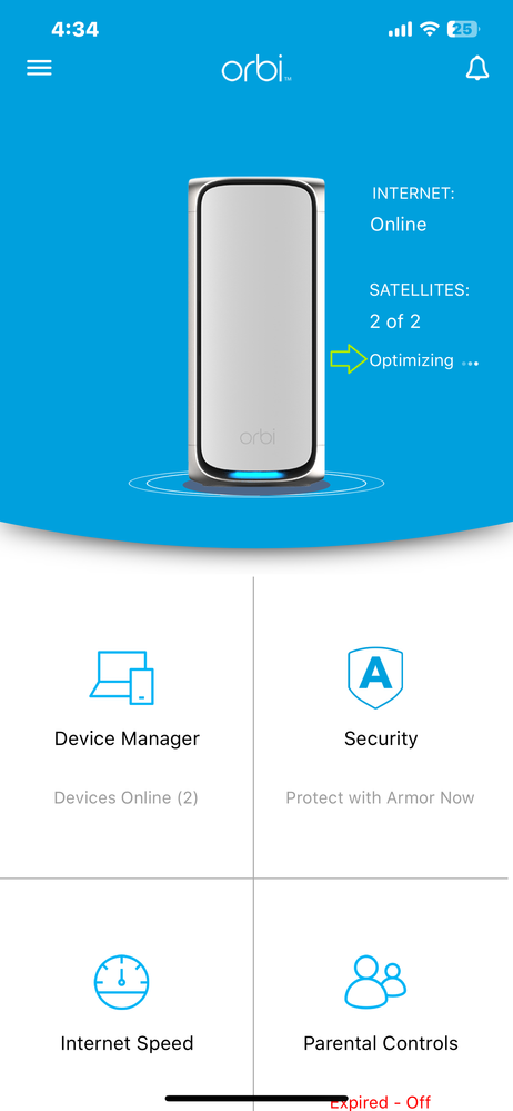

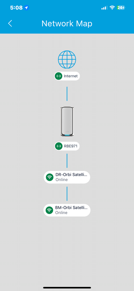

OK, finally, got my two RBS in daisy chain configuration. Orbi app and the system needs time to get set up and settled in. Orbi app wasn't immediate to reflect that the RBS were in DC configuration until I thought it wasn't working. After several minutes, finally displayed DC configuration:
So seems like 5-10 minutes maybe need after the RBS is power cycled and reconnected that triggers a Optimation process thats seen on the Orbi app:
I'll leave this running over night and check again in the morning.

Before going to bed last night and waking this morning, RBS are in DC configuration. I'll leave it running this week.

My system still in DC configuration as of this morning.
