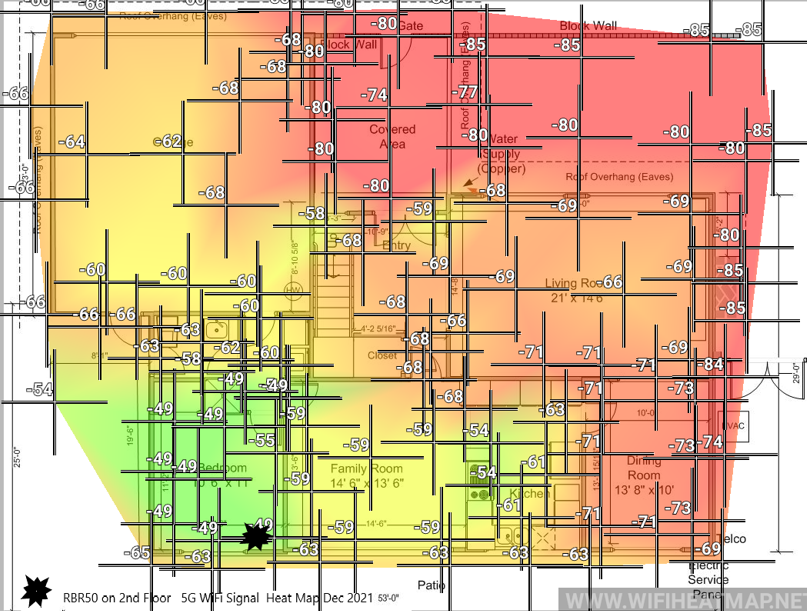

What sort of resources do you have to record WiFi signal levels?
Windows laptop, Chromebook, Android tablet all have free applications which can be used to map WiFi signal levels and document what is going on.
For example, my Orbi is located where the Spectrum cable enters the house in an upstairs bedroom. For some time, (someone in my family unit) would comment, "The WiFi is horrible when I am in (a) the dining room, (b) the corner of the living room, or (c) outside on the front porch. Running a Heat Map application on an Android tablet produced this:
Notice that downstairs (directly below the router) the WiFi signal was great. In those areas of concern, WiFi signal was terrible. (Hence the complaints.) Satellites to the rescue!
