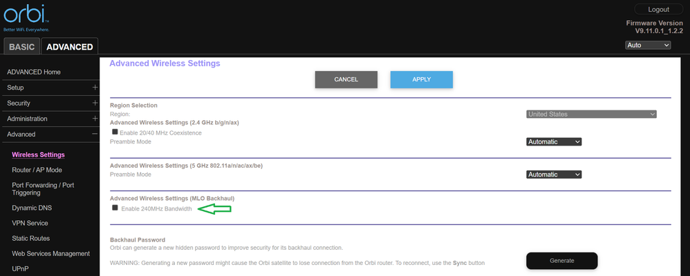

Also what is the current wifi channel configuration set on the RBR?
Is 240Mhz backhaul enabled down Under Advanced Tab/Advanced Settings/Wireless Settings on the RBR?

Are you sure is this area?
- FURRYe38Jan 31, 2024Guru - Experienced User
Ok, Seems that option was removed.

I just put my 970 series online and checked this, interesting that mine has the 240Mhz MLO BH setting in the WEB UI:
I'll check into this..

Strange indeed, so some person has it while some don't
I'll inquire about this.

AH, OK, explains that a bit. There seems to be in region and out of region UI behaviors. I'll check on this to be sure for you.
As long as you see 5+6Ghz there, your good. Means MLO is enabled and working.
