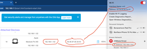

Another bug? Router does not see the manual IP address
Check this image out. I have my MacBook Pro set with a manual address - 192.168.1.154. Yet the router admin web page Attached Devices, and the Orbi app, show it as 192.168.1.22 - an automatic IP/DHC...

Assuming that Manual IP refers to a Static IP (along with subnet mask,gateway IP address, DNS IP address) that was defined on the MacBook Pro, there is a chance that the Orbi has remembered information, having previously used DHCP to assign 192.168.1.132 (not 22 - perhaps a typo?).
Could you please set up the Static IP on the MacBook Pro, then restart the Orbi router?
(This will clear the Orbi ARP tables.)
Then connect the MacBook Pro to the Orbi WiFi at 6G and report what the Orbi and MacBook Pro report for the IP address.

CrimpOn you nailed it! After a reboot the router admin web page and Orbi app show the Mac WiFi on .154! I then put the Mac on 6E from 5. No change, all fine. For awhile I found on my 2 Macs if 6E was on, IPv6 failed. I'll keep an eye on that, IPv6 is working now! Maybe the reboot helped that too.
