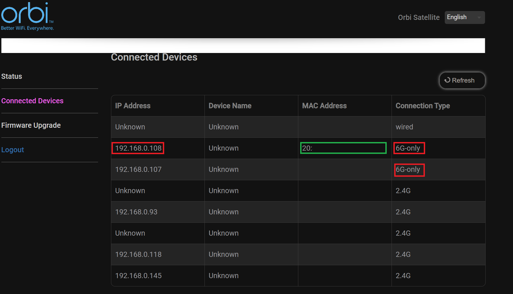

Looks like this is happening on the 770 series as well.
Here is my iPhone 12 Pro Max, Private WiFI address disabled, static IP set for .22.
RBR IP address range set for .100 thru .150 here.
It's appearing in the RBS web page as .108 along with the connection status reporting as 6Ghz only? I know thats wrong. I need to find out whats at .107 thats on 6G only. I presume thats incorrect as well.
I'll have to forward this on as I can't do more until mid week.

Ok so this is happening on a Samsung Galaxy Tab 7 FE (Android) as well if I set it to a static IP address (192.168.0.22) that is outside of the current default IP address range on the RBR770. It briefly appeared on the RBRs web page then disappeared. I found the pads MAC address on the DR RBS however the IP address seen there is .105 and Connection Type is 6G Only. Pad doesn't support 6Ghz. RBS are ethernet connected to the RBR.
Also the .107 Address I found is a Amazon Echo Dot Gen 2. IP address is correctly reporting on the RBS web page however, Connection Type is not correct, Dots are not 6Ghz supporting. The other Echo Dot is reporting correctly at the RBR. The device listed with .241 IP address is a old NG WNHDE111 wireless bridge that has a static IP address configured on it. It's reporting the IP address correctly, however, Connection Type is not correct, This wireless bridge is not 6Ghz supporting. - CrimpOnAug 12, 2024Guru - Experienced User
