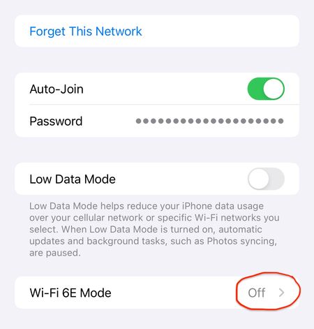

My iPhone just went into this “won’t connect to anything” state again. It won’t even connect to the Orbi 971 2.4Ghz IoT which should have nothing to do with the 6Ghz band.
I turned off the iPhone 6E mode (it will remain off!) , I then went to WiFi Settings (remember, I haven’t moved from the same spot inside my house since I noticed I lost WiFi connection earlier today because Apple News wouldn’t load, because of no WiFi/internet connection, even though my iPhone still showed full Orbi WiFi bars?!?!? How can this be?? ) to select the 2.4 IoT setting, my iPhone had already automatically connected via 5Ghz band to main 971 router!
