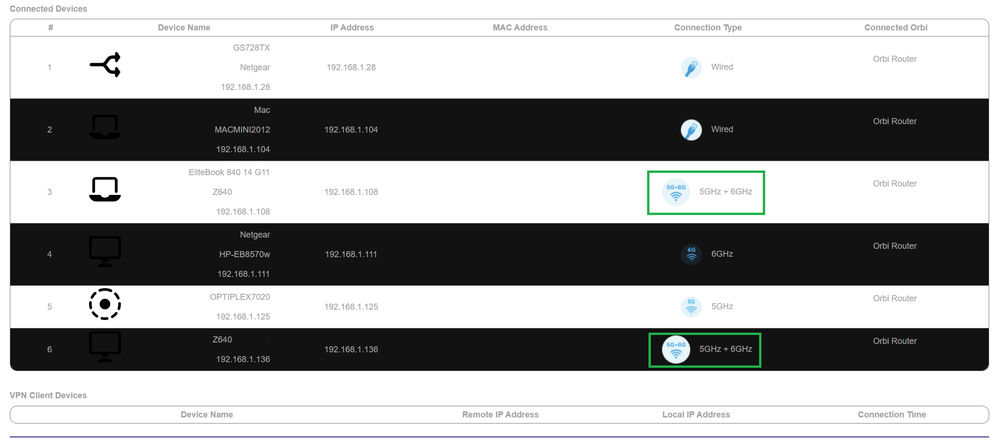

What WiFi7 and MLO active looks like on my 970 RBR with Intel BE200 series cards install in two PCs:

Apr 06, 2025Guru - Experienced User
