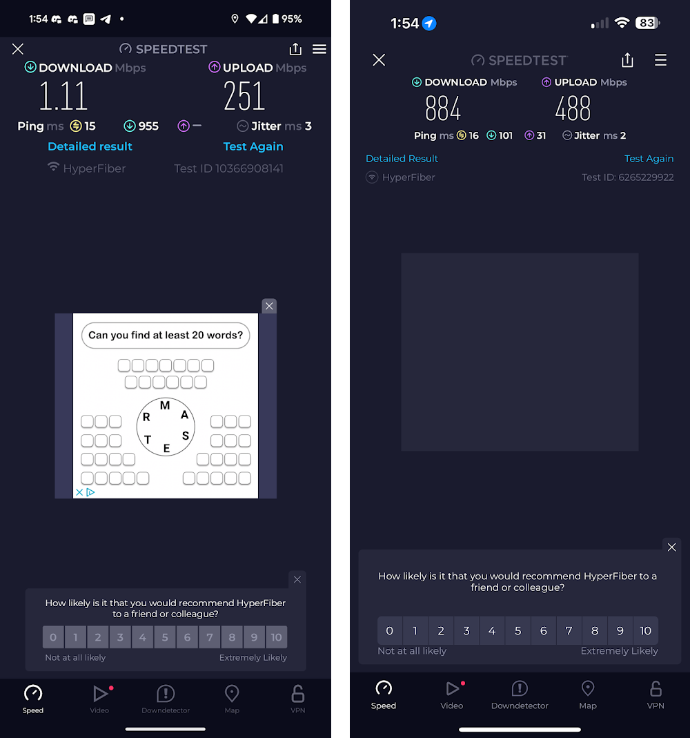

- TheBlackTruthSep 10, 2024Aspirant
Same here. They have been yanking me around with an open ticket and about half a dozen beta FW updates for the better part of 6 months now with zero insights as to what is wrong or why this is happening.
I have a Pixel 8 pro and also an iphone 15 I test with.
These taken within a minute of each other (pixel 8 pro on the left of course).
The behavior resets after toggling wifi off/on and then it occurs again with no particular trigger identified. This seems to happen with other google devices as well such as my google TV, etc.
