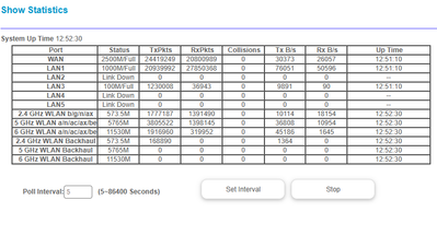

So when you notice that the WEB Ui show stats have changed and the uptime resets, do you observe actual issues with the system? Disconnects and does the front LED on the RBR turn PINK or RED when this happens?
Wondering why the Debug and show stats data differs. I've passed this onto NG.

Rebooted again...this time its shows all rebooted 12 hours 52 min ago. 9am pst. so why? I did get a message from Sepctrum that they would be dong some work in my area about that time. THey said I could see 15 minutes downtime. So maybe that what happened this time. But even if Spectrum went down, you would think that only the WAN would show 12 hours and everything else would be higher right?
- FURRYe38Mar 16, 2024Guru - Experienced User

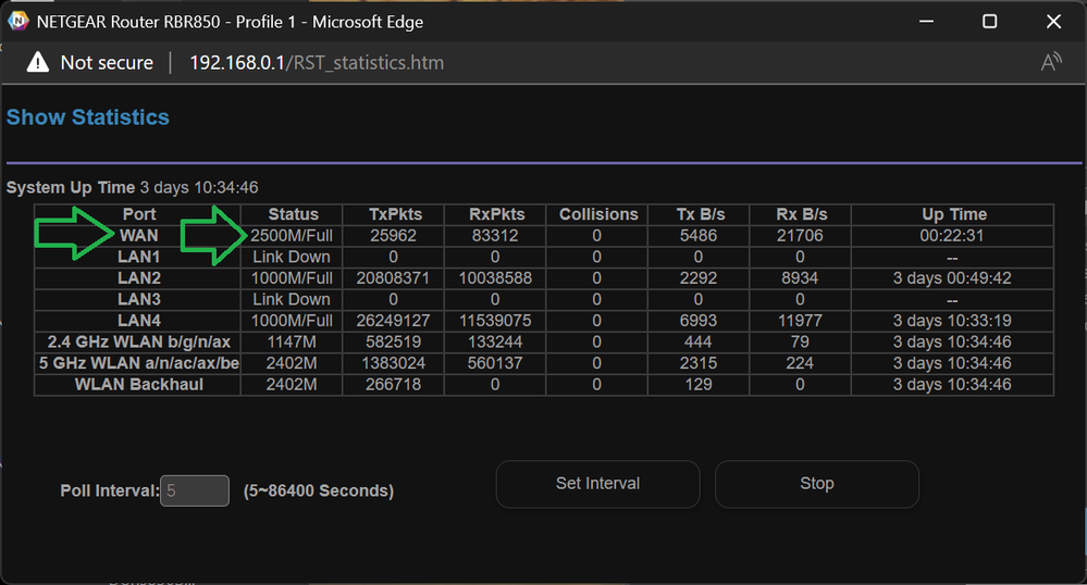

Ok I think this maybe an ISP thing or the RBR maybe reacting to something happening on the WAN port.
I just put a CM3000 series cable modem online today. I did not reboot the RBR I have connected to it.
I noticed that after the system was fully up and running and ready, I checked the Show stats button the the RBR850 I have connected to the modem and saw the UpTime on the WAN port of 22 minutes:However looking at the RBRs debug page, the system uptime there hows 3 plus days of up time. Hasn't changed here.
So I don't think the WAN port uptime is not tied to the debug page uptime. The WAN port uptime is actual connection up time between the RBR and ISP modem or ONT. So if the WAN port is changing up time randomly and the debug page isn't, I guess the WAN port is seeing problem coming from the ISP modem/ONT here. Debug page is reporting full system up time which hasn't changed on yours.
If the ISP is letting you know there doing things, you'll need to keep track on this and keep monitoring the WAN port up time along with debug just to be sure. I guess these will be different values for you. Hoping that the ISP will be correcting what ever is happening on there side and the RBRs WAN port will stop loosing connection with the ISP services.

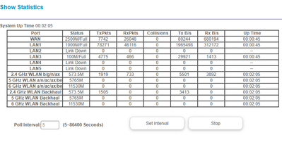

- JesseDiazMar 19, 2024Guide
4 reboots since last update. Here is the latest which just happened.
- FURRYe38Mar 19, 2024Guru - Experienced User

Ok so both WAN and Debug pages were reset.
Please continue to monitor and observe the CPU Usage and see if you notice any creeping for this value in a upwards direction or if it seems to crest at a certain value.
