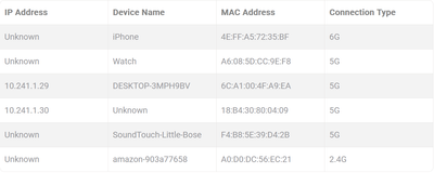

Just chiming in here with just one of many issues I have been having with my Orbi 870/871 devices. I am set up in AP mode (we wont get into the issues with this) and, looking at the attached device...

Do these devices appear correctly on the RBRs web page?
If this is from the RBS web page, there has been some odd behaviors around what the RBS report. I would agree, should be reporting correctly if all devices and names and MAC addresses are aligned.
Phones and pads, make sure you disable MAC address randomizer on them...

From just a single satellite. More devices on others show similar. 1st 2 are and iPhone and iWatch. .30 is a Nest Thermostat, The next one if a Bose Soundtouch, and the last is an Amazon Firestick. It's not just iPhones.

They do not show up on the main RBR devices connected page. Example, the SoundTouch would be .111 and called Little Bose and it is missing. So are others.
