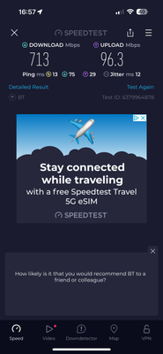

Orbi 770 Satellite Slow Ethernet Speeds
Experiencing issues with wired connections to my 770 satellite. I've got the satellite connected on wireless backhaul to the main router about 15ft away. I've run tests both on my IPhone 16 Pro conne...
