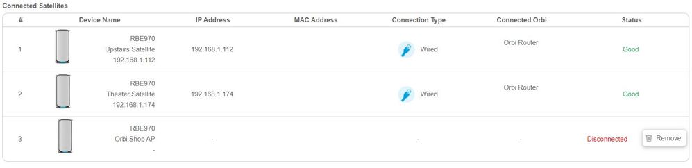

An update to this. I got the RBR50 connected as an AP and have it set to its own SSID. It’s working fine. I get full speeds.
That being said…the 970 seems to recognize it as another 970 satellite. It shows up on the admin page as one and is stuck in Config Sync for the status.
Any thoughts? It doesn’t seem to be causing any issues but I’m not sure if it eventually will. I haven’t tried it in Router mode yet. AP seems like the most logical choice.

Got a picture of this?
The RBR50 is ethernet connected to the back of the RBR970?
Shouldn't be seen by the 970 series as a satellite...
- MyriadRockerJul 07, 2024Aspirant
Yep, see below. And yes, it is wired. You'll see that there are 3 satellites connected, but I only have the two satellite system. The second one in the list is the RBR50 and it has been in that Config Sync status ever since I got it hooked up earlier today.
- FURRYe38Jul 07, 2024Guru - Experienced User
Interesting. Possible the FW isn't tuned fully for the RBR50.
Does this one entry disappear if you turn OFF the RBR50 in AP mode?
- MyriadRockerJul 08, 2024Aspirant
It shows up as disconnected like a normal satellite would. Odd.
