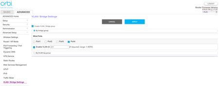

Orbi 870 with CenturyLink Fiber and VLAN 201 tagging
I just purchased and installed Orbi 870 (router + 1 satellite). Is my 3rd Orbi system. I live in Seattle and have Centurylink 1Gbps fiber. CenturyLink does VLAN 201 tagging. The Orbi has a ...

After some experimenting I learned.
1) have to select VLAN tag group (not by bridge group), add VLAN 201, select all wired and wireless ports
2) can't just save the changes, must also power cycle the router

- JoeJoeJoeJoeApr 10, 2025Tutor
Thanks for your comments
