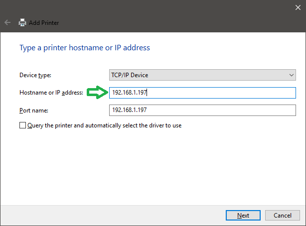

Ok, did you set that IP address with in the printer driver on the Windows PC?
The IoT network is not isolated from the main LAN or WLAN as NG wanted to ensure connectivity between IoT devices on the IoT Network and there supporting apps on devices connected to the main LAN or WLAN.

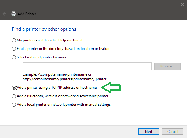

Have you tried to install the printer manually in Windows by manually adding the printer using the Local printer, then selecting TCP/IP in the Add Printer path in windows?
Then continue to navigate to where you have the driver for the printer in a folder or select from the pre listed Epson drivers. Something to contact your printer Mfr about that.
