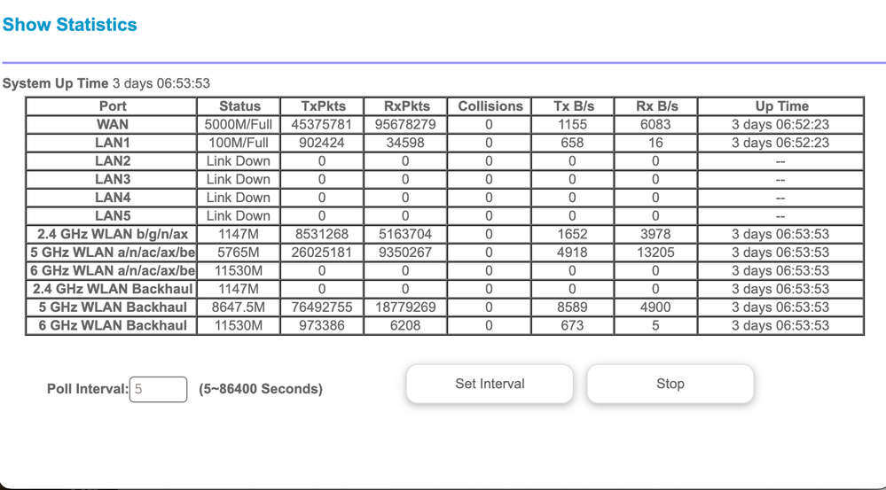

Orbi 970 6 GHz WLAN Backhaul RxPkts 0
I'm running firmware version V9.11.1.1_1.2.2 with Orbi 970 (RBE973SB), router with 2 satellites. In the connection statistics I'm noticing that the 5ghz backhaul is showing Txpkts/Rxpkts activity bu...

Home is ~3,000 sq ft. all one level. One satellite is about 20 feet and the other 30 feet away from the router. Both satellites are showing 5GHZ + 6GHZ connection type since I set them up a few days ago (screenshots below). In the web interface the connection type matches 5GHZ + 6GHZ and has status of Good.
Should I try putting one satellite closer to the router for a few hours to see if I that increases 6GHZ rxpkts activity and rule out building material interference?

Thanks for the help 🙏! As soon as I moved a satellite into the same room as the router I started seeing RxPkts on the 6GHz backhaul.
Even though the satellites are closer than 30 feet I think the L shaped house + building material + number of walls between router/satellites are likely preventing a stable 6GHZ connection? (router is in the corner of the L and satellites are in each arm of the L)
