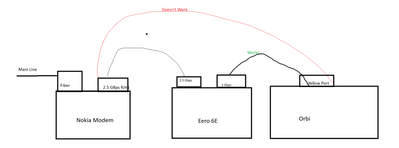

The Nokia model is X5-010X-Q. The fiber connection is coming into Nokia modem and it has 1 Ethernet Port (2.5 Gbps) for internet connectivity to routers. When I connect it to Orbi router, the purple light starts blinking and no Orbi says no internet. But when I connect Nokia modem to Eero 6E router it is working fine. Eero 6E reports speed closer to 2.5 Gbps (as expected). Then I connect Orbi to Eero 6E's 1 Gbps port and Orbi is working fine. The question is what is preventing Orbi to behave erroneously when it is connected directly to Nokia.

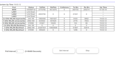

What does the Orbi web interface, Advanced Tab, Show Statistics display for the WAN port?

I have tried multiple ethernet cables now. Like I mentioned in the original post, right now I have connected Orbi through Eero 6E 1 Gbps switch and it is working . This is what my advanced Statistics shows. Please guide me and I can go to other pages and provide the required information. Can you clarify what you mean by Ethernet switch. Is it just ethernet hub?
