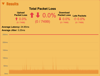

FredCC if you go to https://packetlosstest.com/ , you can choose a "Preset Approximation", which changes settings based on the type of usage you are interested in checking. I would recommend in your situation picking VoIP, Zoom, or both as comparable settings. Run the test, and not only check out what it reports for packet loss and average latency (let us know here), but check the graph (image below) to see if you have some big spikes in response time. The graph below is my 30 second 'Zoom" test.
Most times, averages are not the issue causing audio/video issues, but intermittent spikes that disrupt transmissions.
Post what you get, and this test should indicate whether your network may be part of the problem here!

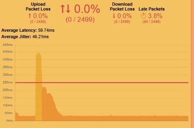

Thank you very much! And thanks to FURRYe38 for working with me on this issue. I was focusing on the RBE772 because this Teams issue started when I replaced my Nighthawk with the Orbi. The Nighthawk provided flawless streaming and Teams meetings with my same ISP and modem. Here is the performance chart ran from my laptop connected to the RBS. Shall I plug directly into my router (wired) to do this test?
- FURRYe38Oct 02, 2024Guru - Experienced User
Plug directly into the ISP modem/ONT and test then test directly to the back of the RBR with the RBR connected to the ISP modem/ONT.

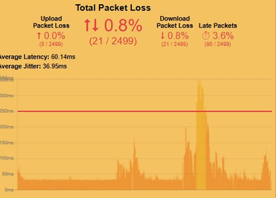

Here is the graph for plugging into the back of the RBR:
Here is the graph for plugging directly into the ISP modem:
Does this spike show that I have an ISP issue?
- donawaltOct 02, 2024Mentor - Experienced User
If it was me I would consider it very possible....in a 30 second test, twice, for well more than a second you have a rather large spike; you have >3% late packets, and see packet loss. Doesn't this seem disruptive? Compare to my graph above.
What is your modem mfr/model? Do you have access to its channel signal strengths, signal noise ratios, or logs?
If you don't, I would contact the ISP and tell them the issues you are having. The more you can find out while plugged directly into the modem, the better - as that bypasses your network and equipment entirely. It would be great if you have a video/audio test online or something that you can test without on demand when you need to, that you can see failing when connected directly to your modem. Your ISP will likely consider that a problem that needs to be fixed.
