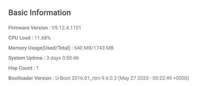

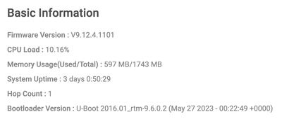

        RealJabberwocky the 971 router reboot via the web site reboots any connected satellites. If they are not currently connected they will not reboot. I have done it about 4-5 times testing different things in the last couple of weeks, I see the 970s (satellites) blink white, and I compare the router and satellite debug pages - the up times are virtually the same after the reboot, as you see here:
        I do it from the router admin web page, advanced tab -
