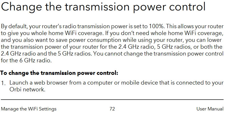

NG also removed the web config option (page 74/75 of their Oct? 2023 300+page version of the 971 manual. It shows how to adjust power for 2.4 and 5 bands. With my onboarding IoT problems, NG community referred users (for previous versions of routers like your 960) to the NG KB about reducing 5Gb band power to 25% (NG didn’t offer the ability to turn it off??) so I immediately went to the 971 file, found power options, and fired up my web gui into 971. I went to the location specified in their most current manual . . . no power options anywhere! Apparently, NG removed those options in some firmware upgrade. The capability to turn off 5G is a necessity, even with their 2.4IoT SSID, that doesn’t work for iPhone apps that have always on 2.4 and 5Ghz bands if the IoT onboarding App needs to do IoT device config settings for the device. Even if the IoT is connected to Orbi 2.4 band on main SSID like I have to do for IoTs located in the same room with the 971 (I can’t get devices to connect to the 971 IoT SSID, they connect to 970 satellites and I have to “move them” to main SSID on 2.4 band). If my onboarding requires the IoT app to talk to the 2.4 IoT device connected to the main SSID on 2.4, my iPhone connects to main SSID at 5Ghz, not 2.4Ghz. The 2.4 IoT won’t listen to a 5Ghz App!! I can’t finish onboarding!! NG still needs an option to turn off 5G band. Note, our iPhone 15 pro max gives us an option to turn of WiFi 6E (so that disables the 6Ghz connection to main SSID when trying to onboard 2.4 IoT’s!).

On the 960 series, the 2.4 and 5 GHz power adjustments are on the Advanced tab/Advanced section/Wireless settings. See if it's the same for you.

- Roc1Aug 01, 2024Luminarylol! The location for the Orbi power settings you provided are shown in that same location as specified on page 74-75 of the 971 manual. They are gone now.
There was a 971 reference to the same location 950 posts ago and earlier this year (before I bought my 971) for 971 WiFi power settings when another Community member had issues on boarding. They were on the 971 web gui then because the Community member turning the 5Ghz power down on his 971 didn’t help him onboard IoT’s. So those settings were an option earlier this year on the 971 web gui. They are now missing from that location. I’ve gone through every option on the 971 gui, they are no longer included.

Roc1 wrote:
lol! The location for the Orbi power settings you provided are shown in that same location as specified on page 74-75 of the 971 manual. They are gone now.I am confused. Page 72 of the 971 User Manual shows this:
Is the comment that
- These instructions are not on page 74-75 (which they are not), or that
- This feature no longer appears on the Advanced Tab->Advanced Menu -> Wireless Settings?
I have seen posts remarking that Netgear has removed Transmission Power settings from several Nighthawk routers. In each case, the change was described clearly in the Firmware Release Notes for the version that made the change.
I have reviewed the Release Notes for every firmware release shown on the 971 router firmware downloads page and do not see any mention of this feature being removed.
(Having no 971, I cannot bring up the web interface and check this myself.)
- FURRYe38Aug 01, 2024Guru - Experienced User
Power settings were removed last year while in beta. Not sure if it will be returned.
- CrimpOnAug 01, 2024Guru - Experienced User
Thanks. Way to go, Netgear.Silly to expect that the User Manual would reflect what the router does (and does not do).
(sigh)
I have a feeling the UM is a template that they took from the 960 series. Probably planned to have power settings in there but they ran in to issues early on and took it out. So depending on how things go, NG may or may not bring it back. Ya, the UM will need to be updated for sure. For now, nothing we can do.
- Roc1Aug 01, 2024LuminaryCrimpon, my page numbers were wrong, and I confused the 971 manual with another 300 page manual. The 971 manual is 168 pages. I was in my 971 web gui today. There are no settings in any tab in the 971 Web gui that allows you to change power on any band now.

This would be easier to validate/correct if the Orbi 971/970 (and 860 Orbi version also) had the ability to adjust WiFi band power. This was originally a config option in the 860 GUI, and it was in a beta version of the 971 (as I understand from Community member Furrye38), but NG had some kind of issue(s) with band power option on the 860, so they removed the capability with an 860 firmware update, and then did not include it in the 971’s when released (even though the 860/971 Orbi Operator Manuals still have not been updated to remove band power config GUI options!
I’m going to see if I can re-locate the mesh nodes within my home so there won’t be spots where the mesh nodes don’t know who should connect to the device. On the 971 mesh series, the router and satellites each have 12 antennae, so this might not be possible without reducing 5Ghz WiFi band power, or adding a large addition on to my home!!
Since 6GHz band is still being used for non-WIFI purposes by other agency/users, the FCC will not allow any power adjustments on 6GHz at this time.
If any Community member’s are familiar with the NG MR6550 Mobile Router that uses a cellular SIM Card for internet connection, it includes all 3 WiFi bands. But, the FCC apparently prohibits the “mobile” (I.e. vehicular) use of 6Ghz band on that MR6550 for fear of interfering with the other users that have not yet moved off this frequency. NG accomplishes this restriction by only activating the 6Ghz band on the MR6550 when the internal battery is removed, and the unit is plugged into a power outlet (vehicular use could be accomplished with an inverter, or other work around).
This specific MR6550 configuration using 6Ghz band would work great at home where the unit would provide home internet with a cellular data plan, and could be plugged into power full-time the with internal battery permanently removed, which would then activate the 6Ghz WiFi band.
I said all that to say, currently NG can’t allow us to make power changes that might help our WiFi 6E device stability if my theory is correct (maybe not!) about location and WiFi mesh node hand-off confusion.
I’ll update Community after I try moving my nodes around and see if that corrects mesh node hand-off drops, and eliminates 5G cellular service flips. - donawaltAug 06, 2024Mentor - Experienced User
