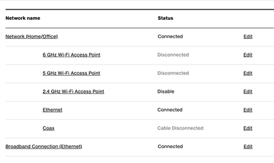

it's CR1000A and if there's a setting to change I will try it!
- Bk1230Dec 26, 2024Guide
I do have this happening but I'm not sure of what other settings I would need to change. I literally had never a single problem on the old router (which I sent to my aunt many states away, or I think I'd honestly have returned to it by now!).
