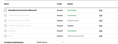

it's CR1000A and if there's a setting to change I will try it!
- Bk1230Dec 26, 2024Guide
I do have this happening but I'm not sure of what other settings I would need to change. I literally had never a single problem on the old router (which I sent to my aunt many states away, or I think I'd honestly have returned to it by now!).

1. those options are not the same as what you linked.
2. ?? unsure because it says it is in bridge mode. IDK where I would find the Netgear IP address.
