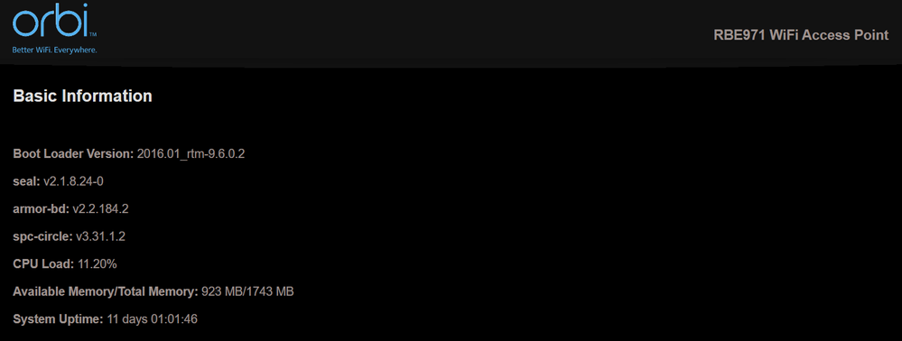

Just had my 970 series in AP mode for past 11 plus days of up time, so I know this works:
Mine was connected to NG XR series router and it connected to a CM3000 cable modem.
