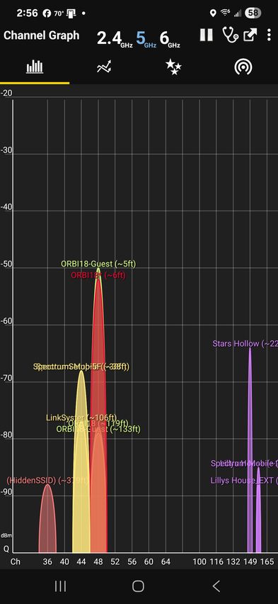

Does this happen with both wireless and wired devices? Yes happens to both. My office has the modem and router in the same room. My desktop is wired to the router. But I see the disconnect on both wired and wireless at the same time it occurs.I use channel 1 and 40 on my Orbi systems. I'm currently on 11 and 48. There are only 4 channels available on the 5G.

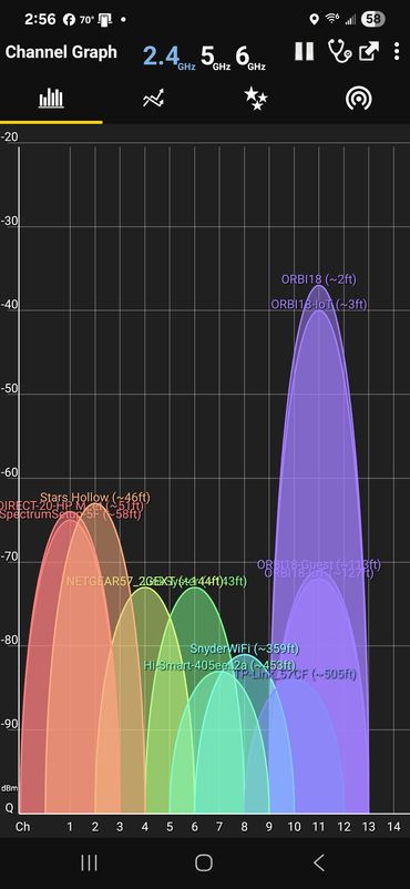

Any Wifi Neighbors near by? If so, how many? I live in a small rural neighborhood. One on either side, plus across the street. No one behind us. I know this is not very scientific, but I have a WiFi Analyzer, freebie of the internet, I did a Channel Graph screenshot of 2G and 5G bands. Again I'm on channel 11 and 48.
