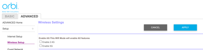

- RichieKB85Feb 28, 2025Aspirant
I just fixed mine by disabling AX features on 2.4ghz and 5ghz here:
It was driving me insane, I had an iPad and three iPhones that kept disconnecting. This solved my problems, maybe it will help with yours.
